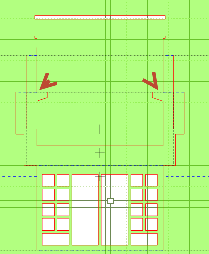

I been tinkering attempting to make with the House Card lenvi posted a question about
Something is happening I just can't make sense of
the finished card would look like this not yet sure if it will actually work how I think it should

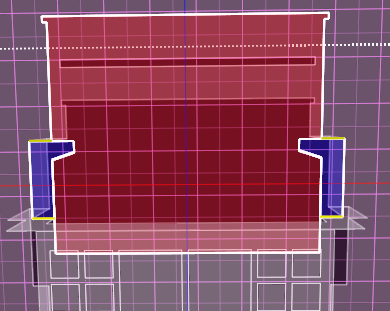

the red shape (roof) and the blue shapes (side supports) are both on the same plane but are still separate shapes
when i print preview the project they seem to have joined

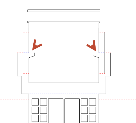

also with the project once imported to MTC
In the case of this project that junction is required to be a mountain fold but
I could not work how to actually join those part together on PCS
So just accepted i would have to node edit the cut line in MTC
As it turns out once rendered there is no line there ?  I don't understand why ?
My only thought is that once rendered the 3 shapes are not longer close paths due to the fold lines
though does that explain why those lines that I would have expected to be unwanted cuts disappear
